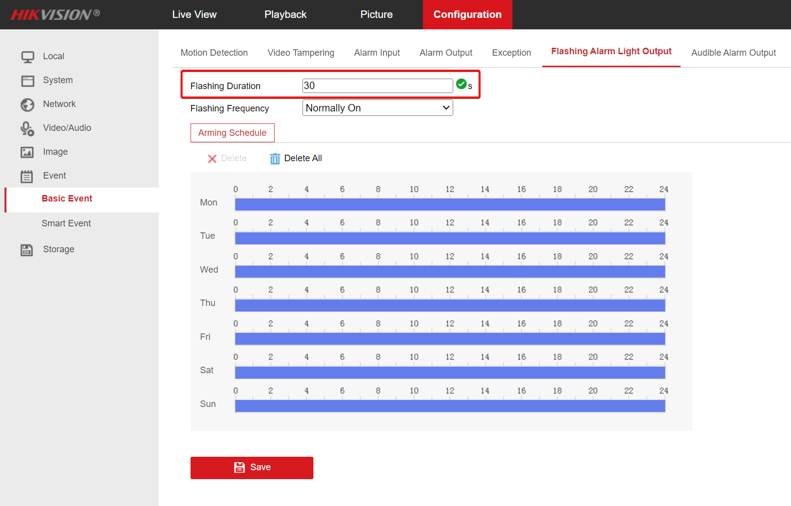

Hi @montydon
If you log into the camera directly, you can adjust the timeout period by going to Configuration>Event>Basic Event>Flashing Alarm Light Output and setting your preferred time in seconds in the Flashing Duration box.
You can also change how the light behaves by using the Flashing Frequency dropdown (Normally On just means the light will turn on and not flash):
