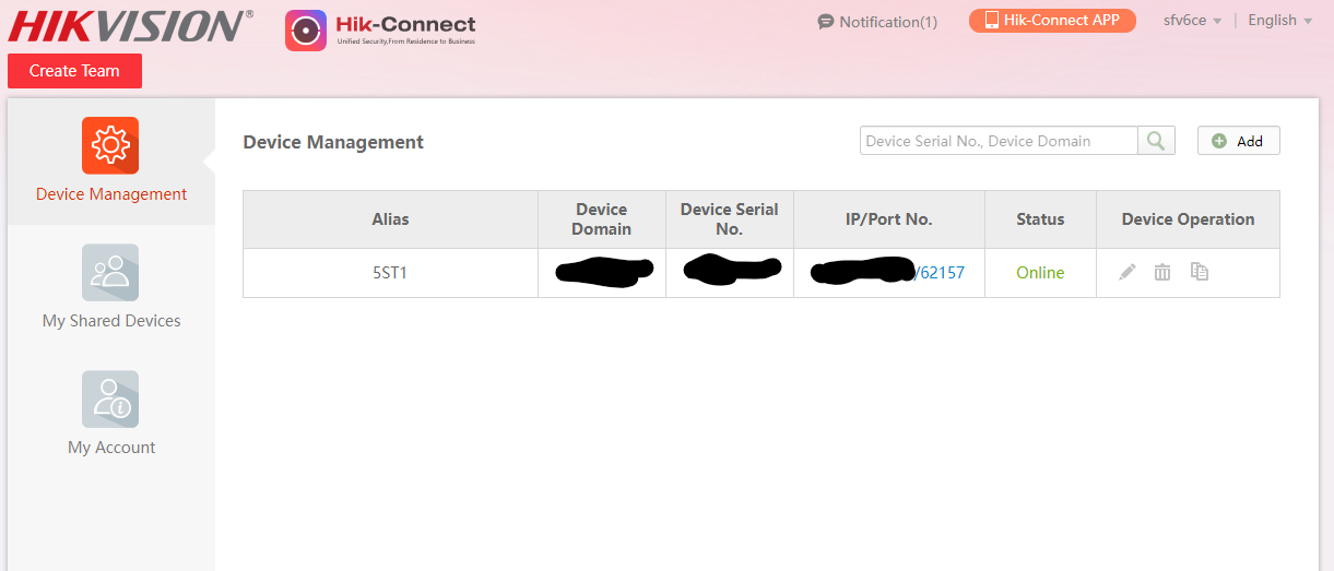

If I login to https://ieu.hik-connect.com/ I can see the NVR (although it has a different Alias) and it shows as online so not sure if I have added the NVR correctly now to the hik-connect app?

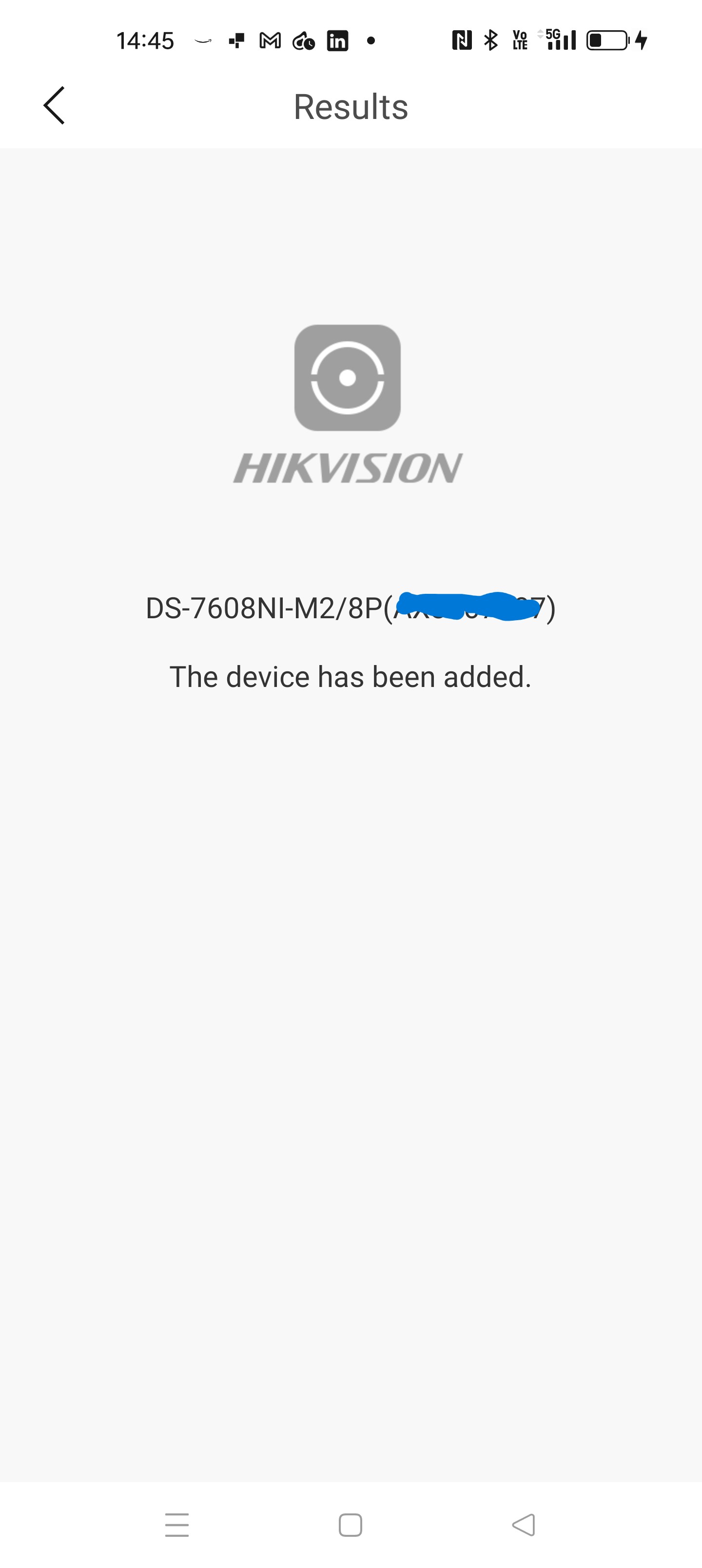

I've removed the 'local' NVR. I've tried to re-add both using the QR code and the serial number - both get as far as the attached screen. There is no 'next' nor does it take me onto the screen where I can name the device or the screen where you can skip the service provider authorisation (as documented in your how-to How-to: - How to add a Hikvision NVR to Hik-Connect)
You can see on the screen there is no way to move off that screen? I can only click < back which takes me back to the previous screen to add a new device.
I updated HIK connect yesterday and am running the version reported as the latest on Hik visions software site (version: 6.4.0.0613, Update at: 2024-06-17)

I get the same screen in your screenshot once the NVR has been added via QR code, and I try to add it again.
So, there shouldn't be an option to progress from that screen other than back.
I.e. Hikvision's servers seem to think that the NVR is linked to your Hik-Connect account, but it isn't showing, which is why it's taking you to that page (thinking it's already added) - very odd...

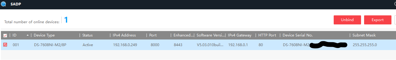

So, try using the SADP tool to unbind the NVR, which should completely remove it from any account it is linked to, and then try the QR code again.

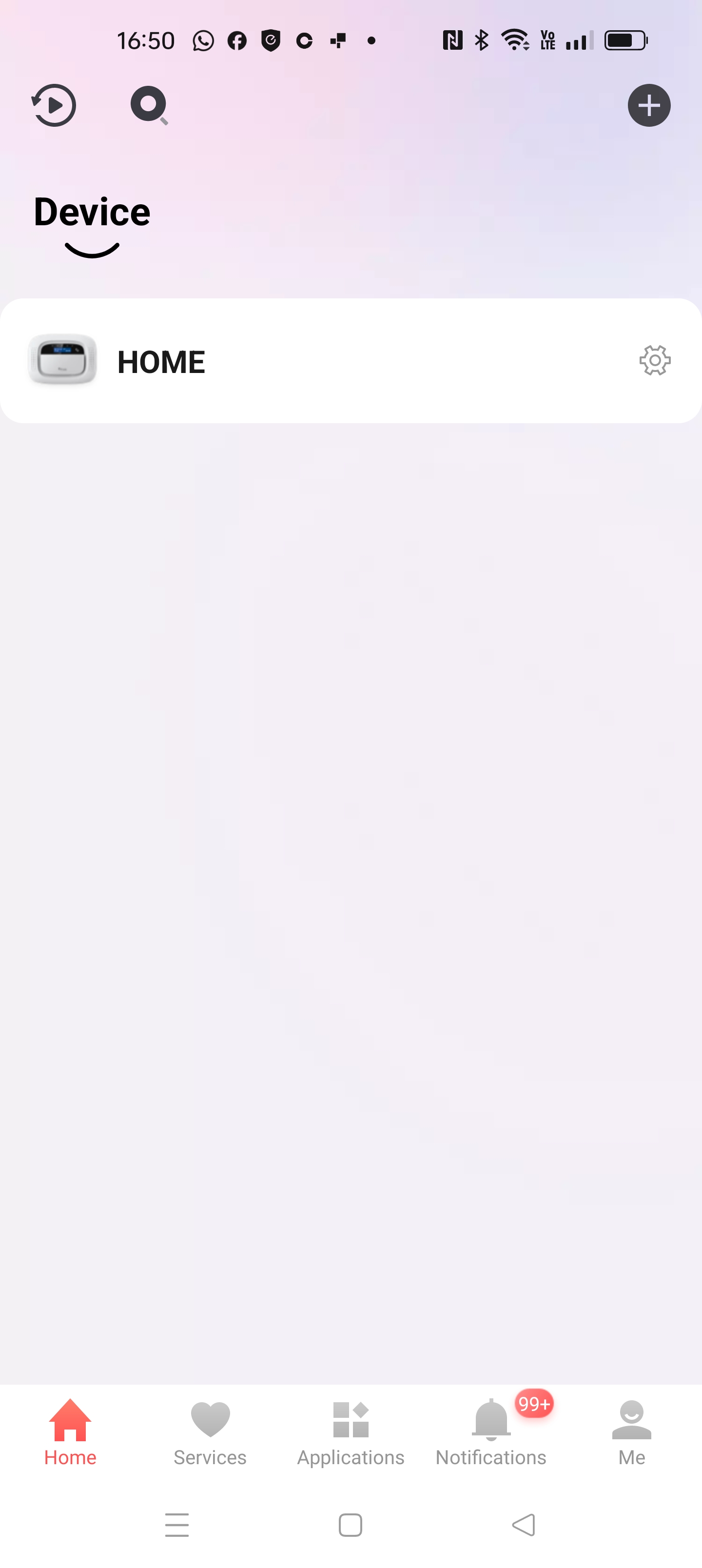

If that doesn't work, can you please send screenshots of what the app home page is showing you, as well as the web portal? (Blur out any serial numbers.)

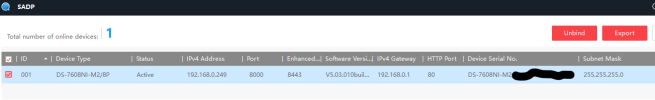

I've gone into the SADP tool - ticked the NVR, clicked un-bind, username admin and the password of the NVR and it says failed. Here are some screenshots
1. android app home page - HOME is my pyronix alarm system
2. SADP screen
3. Web portal - I've also blanked out the IP (which was the public IP) 86.19.xxx.xxx
