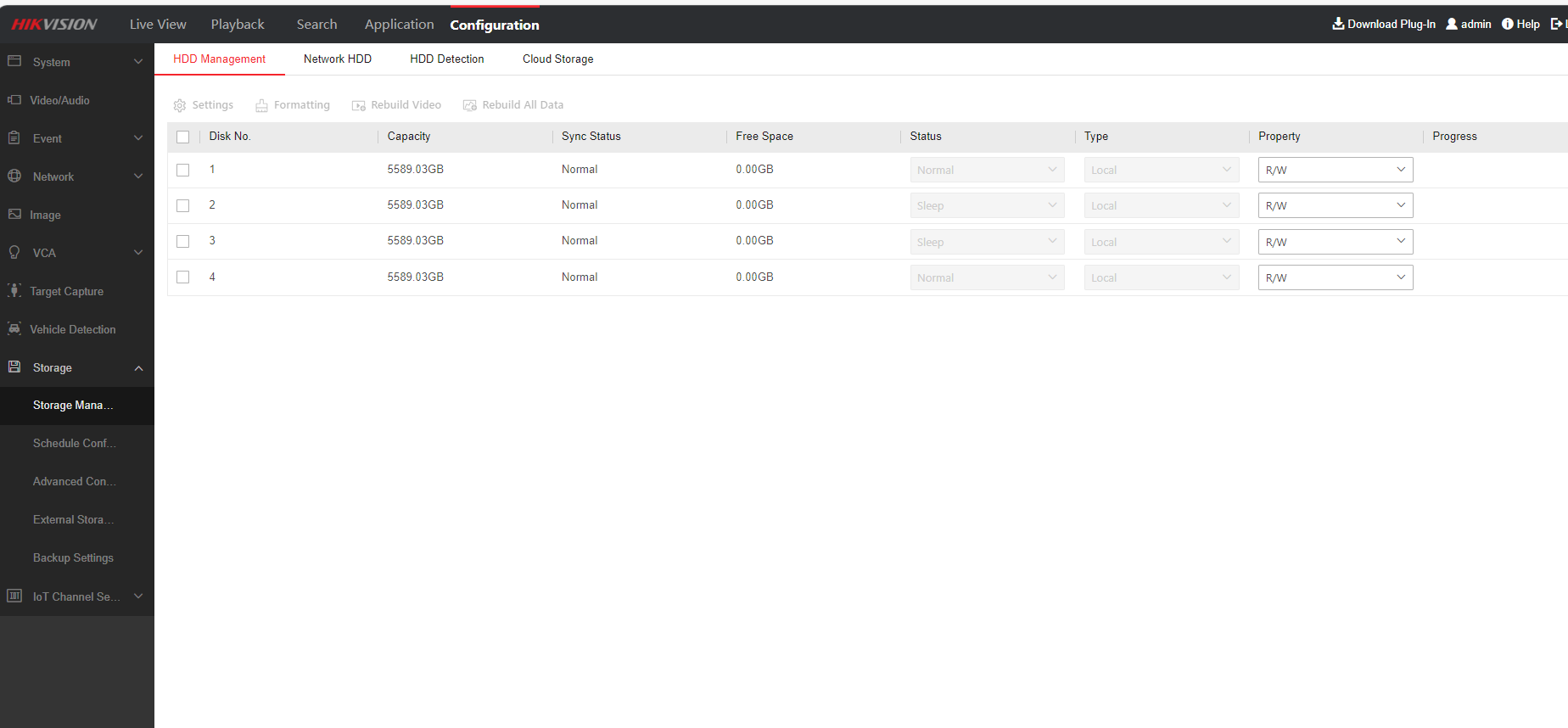

I have checked everything and its all correct, but cant find Save VCA Data.
Using a web interface I have
Storage
HDD Management
Net HDD
HDD Detection
Cloud
Other settings in Storage are
Schedule
Advanced - Holiday - others
External
Backup
Am I missing something obvious?
