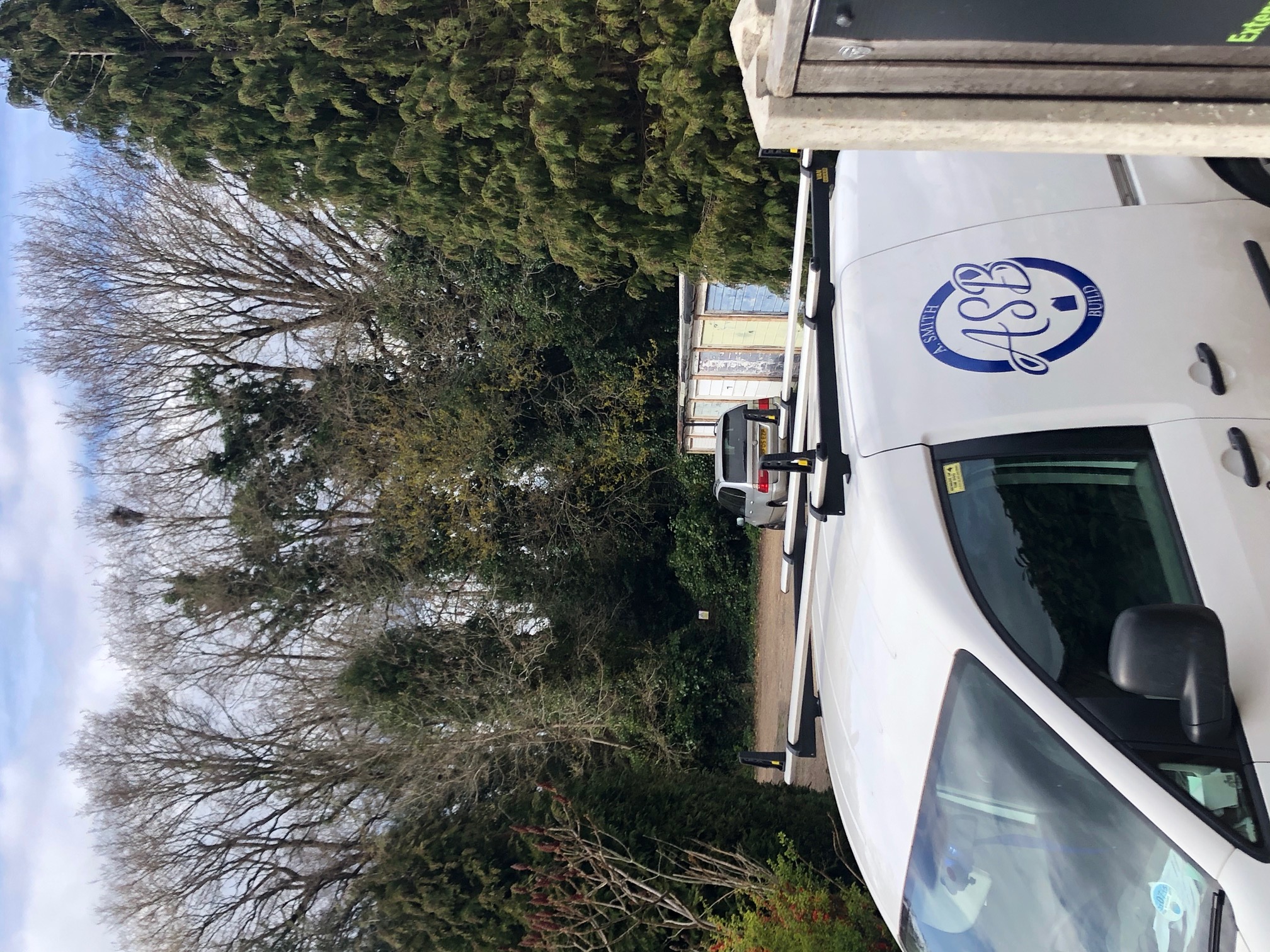

Not the greatest pic i'm sorry about that. However, should show you how far away.
I've already got the 4mm fitted and in use, so i am stuck with it. So i thought i would ask about what the best quality settings are for a longer distance?
img_6157-002-jpg.5568
There are no better quality settings for distance - the image settings would be the same regardless. To give a better idea of the distance, take and share a snapshot directly from the HikConnect app as that will give the view as seen from the camera and allow a guesstimate of the percentage of screen view that the garage occupies. It will however only confirm whether or not you have the right camera for the job.
