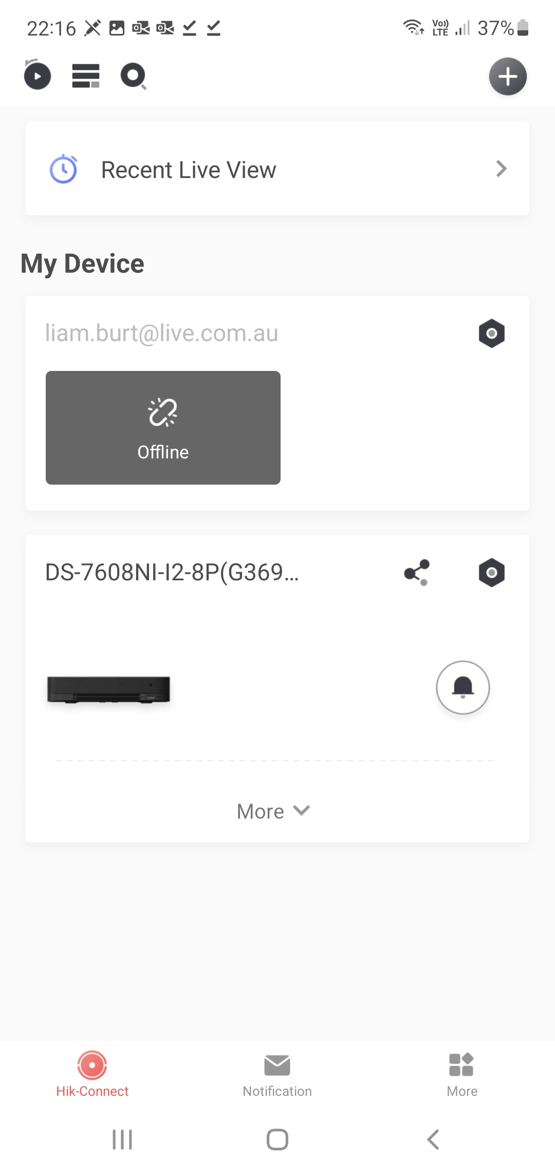

I've lost the ability to arm my cameras.
See other thread for my background :)

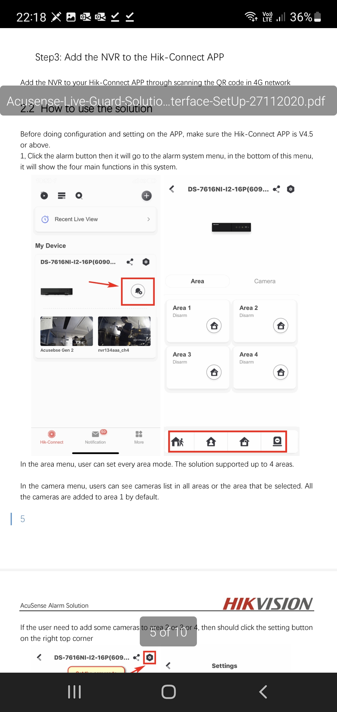

With that 'new' button, where would I expect to access the page where you arm the areas and open the camera details.
The old button was a bell with a hexagon/cog. Now it's a plain bell.
My current screen can't open areas/partition to arm
Old screen (screenshot from a how to file, that looks similar)
I think I've now realised what your issue is and it is not related to the camera firmware. You have updated the NVR firmware from a special customised version which is on the page below. Updating from that version will remove the customisation, so if you need that arm areas function, you'll have to remain on the older customised version:
